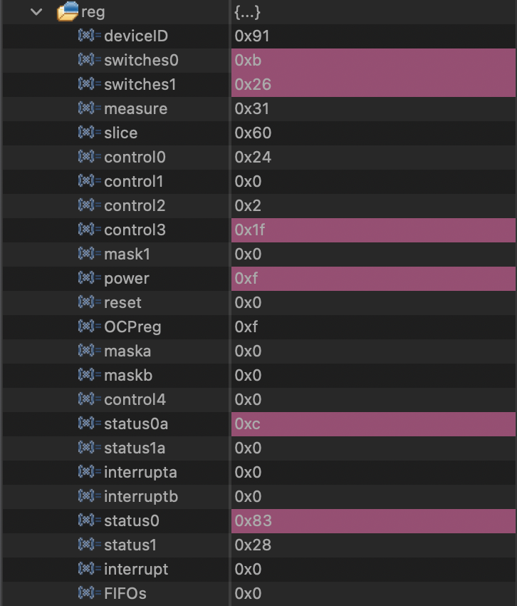

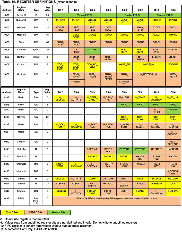

Here is register map of FUSB302B:
And here is my register setup after FUSB302B_start_CC_communication():
The function is doing following things:

I think after I execute FUSB302B_start_CC_communication, bit4 of status1 (RX FIFO Full) should be set because the source should transmit some data and PD controller received it, but after I execute it many times, the bit always stay 0.

Something I guess may cause the problem is the speed of MCU is not fast enought, power converter IRQ using most of resource of CPU.
I measure the main loop period is around 1.5 second (by measureing LED5), and PD protocol defined the sink device should send RDO(request data object) to source in 500mS after Good_CRC been send.
For bypass the resource issue, I try decrease the interrupt frequency from 200kHz to 100kHz, but it still the same.
Also I try to disable AUTO_CRC and it has no effect either.
