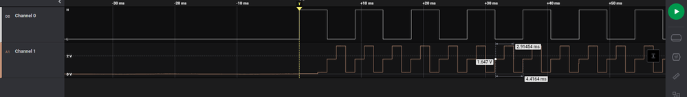

Hi, I have a problem with DAC output, same problem with STM32L4 and STM32H7. I have to continuously output a step wave (3 levels), for this purpose I use a Timer and DMA in circular mode to output an array of 3 values.
The code is very simple, I use a GPO as a sync pin to know when every DAC cycle start and end. If you look at the attached image the 1st period has 2 empty steps at the beginning and then the 1st array value at the end, from here all others periods will result in a shifted wave compared with the trigger/sync pin . What is wrong? What I don't understand? Attached there is also a simple IOC file of the project.

Can someone from ST give a feedback about this behavior? Is it a HAL implementation bug? Is it our misunderstood? At this state we can't use STM32H7​ for our project.
