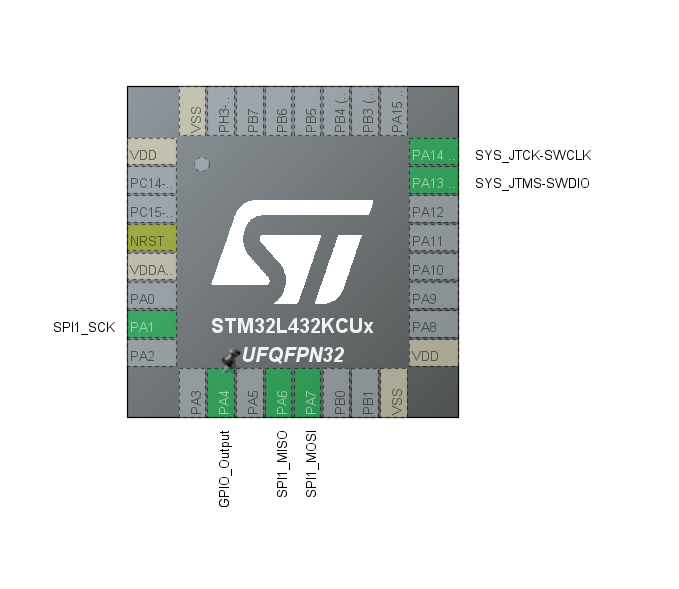

My .ioc pinout view looks like this:
Note: In video, the SPI1_SCK has been automatically given to PA5, but for my board it was shown as PA1, hence have made the connections accordingly.

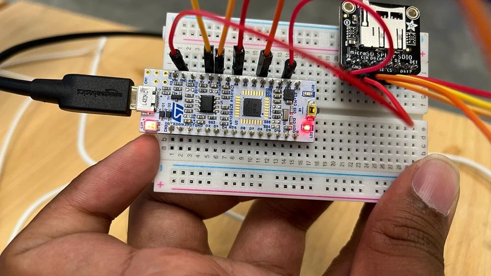

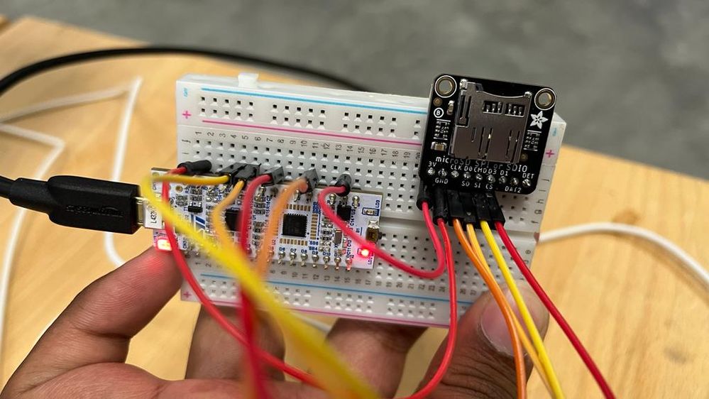

After following the video, My build is complete with no errors. Then I make the hardware connections for my board like this:
(Please excuse the microSD card not inserted in the slot)

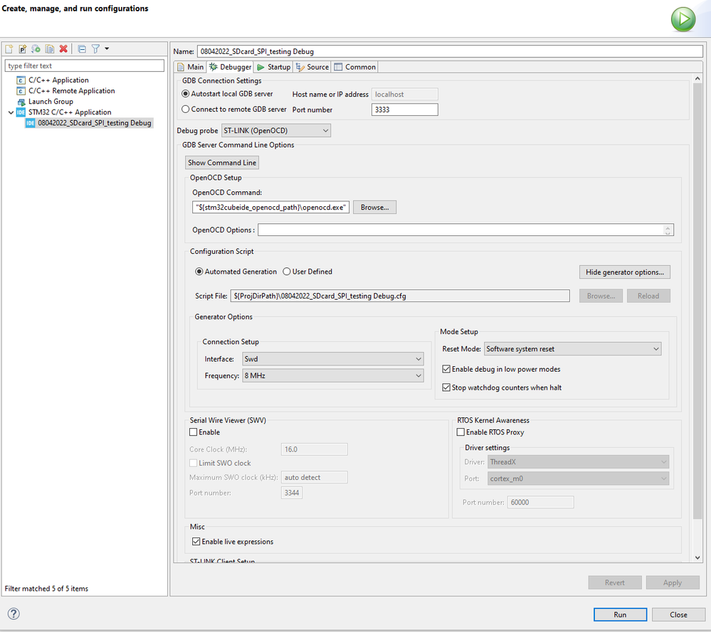

When I am running the file to download the code to board, I am changing the run config file as shown in the video: changing the debug probe to OpenOCD (I don't know much about what this does) and changing the Reset mode to Software System Reset.
So when I click on Run, I get the following error:
Open On-Chip Debugger 0.11.0+dev-00449-g53fa0f7 (2022-06-09-09:42) [https://github.com/STMicroelectronics/OpenOCD]
Licensed under GNU GPL v2
For bug reports, read
http://openocd.org/doc/doxygen/bugs.html
Info : Listening on port 6666 for tcl connections
Info : Listening on port 4444 for telnet connections
Info : STLINK V2J40M27 (API v2) VID:PID 0483:374B
Info : Target voltage: 3.265263
Info : Unable to match requested speed 8000 kHz, using 4000 kHz
Info : clock speed 4000 kHz
Info : stlink_dap_op_connect(connect)
Info : SWD DPIDR 0x2ba01477
Info : STM32L432KCUx.cpu: Cortex-M4 r0p1 processor detected
Info : STM32L432KCUx.cpu: target has 6 breakpoints, 4 watchpoints
Info : starting gdb server for STM32L432KCUx.cpu on 3333
Info : Listening on port 3333 for gdb connections
Info : accepting 'gdb' connection on tcp/3333
Info : device idcode = 0x10016435 (STM32L43/L44xx - Rev Z : 0x1001)
Info : RDP level 0 (0xAA)
Info : flash size = 256kbytes
Info : flash mode : single-bank
Warn : GDB connection 1 on target STM32L432KCUx.cpu not halted
undefined debug reason 8 - target needs reset
Warn : GDB connection 2 on target STM32L432KCUx.cpu not halted
target halted due to debug-request, current mode: Thread
xPSR: 0x01000000 pc: 0x08000e9c msp: 0x20010000
Info : Padding image section 0 at 0x08006304 with 4 bytes (bank write end alignment)
Info : dropped 'gdb' connection
xPSR: 0x21000000 pc: 0x08000fc4 msp: 0x2000ffdc
shutdown command invoked
