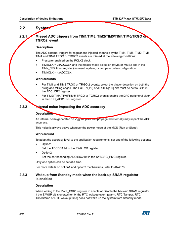

Hard to tell from your description, but maybe this erratum
The workaround for TIM2/TIM4/TIM5/TIM6 is charming and I wonder how does it work...

Thank you very much for your answer.
As it turns out I had actually downloaded the wrong Errata sheet (for STM32F76xxx instead of STM32F74xxx).
Nevertheless I just tried these workarounds, but they didn't help.
But since it is working now with TIM1 I'm okay with that.
Thanks again.

2023-02-17 2:51 AM
Enabling the DAC clock actually did the trick!
(So I got me the wrong errata sheet and when I got the right one, I made some mistake when I tried to implement the workaround... now that's worth some guild and shame).
Thanks a lot!
