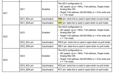

PA6/PA7 are not supported pins for the I2C bootloader.
PB6/PB7 are supported. Perhaps you misread the table.

Have you checked whether PB6 and PB7 are boot pins for I2C?
And to confirm the good/correct connection for the signals.

Connection is correct and accorrding table which TDK posted it should be available for fw upload. I've connected them to RPI GPIO2 and GPIO3 (SDA, SCL) and added 4.7k ohm pullup for both lines to 3V3. When CPU is not in bootloader mode I can see SCL and data are flowing but when enter to bootloader mode by put boot0 pin (soldered on SB12) to 3V3 and then put nRST to GND and back to 3V3 I cannot see any clocks when run i2cdetect on RPI.
