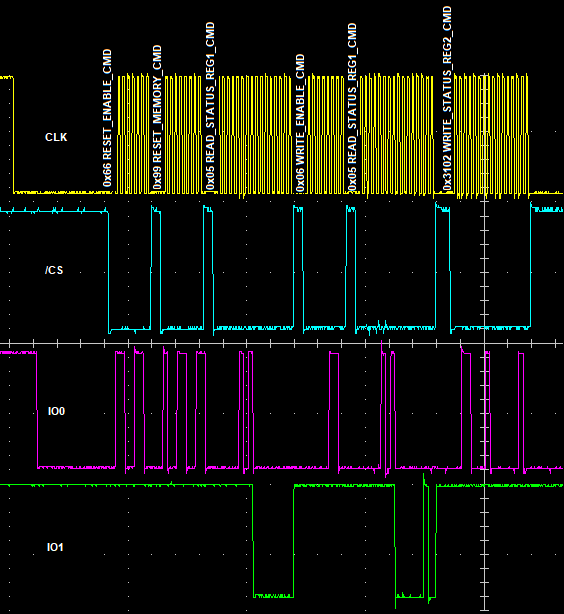

I joined a plot of initialize function, it looks like everithing is ok, there are signals in all wires
