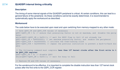

You need to respect QUADSPI internal timing critically as mentioned in the erratasheet.
For that, an additional code must be executed upon reset and upon switching from memory-mapped to any other mode:
Thank you.
