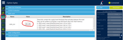

2024-09-06 10:33 AM
You can adjust it in STM32CubeProgrammer along with other option bytes.

No. Use STM32CubeProgrammer.
2026-01-26 6:46 AM
I've moved the code posted above to immediately after HAL_Init() and it runs OK. I haven't seen any problems yet from slow powering up that I was seeing before. I'm very surprised ST didn't include that in the IOC section. I will use it from the Cube Programmer unless anyone finds it lurking in the IOC anywhere. Device is STM32L412
