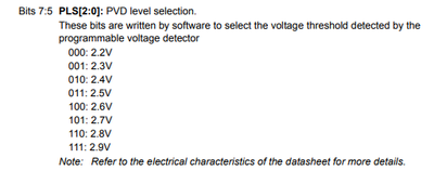

The F103 will be reset if voltage drops below a threshold. According to DS5792 (2.3.2 Power supply supervisor) the threshold value can be influenced by 3 bits PLS[2:0] according to Table 12 "Embedded reset and power control characteristics".
See RM0008 "5.4 Power control registers"
(F103 seems not to have more sophisticated brown out behaviour like F4xx and others.)

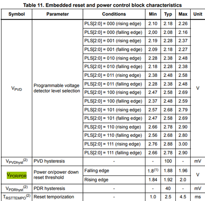

Hello @Shanmugapriya
Based on table 11 of the product datasheet, ensure that the voltage does not fall below 2.0 V to ensure functionality at extreme conditions.
and like @mfgkw said, you can modify the power mode by setting the PLS bits in the power control register.
