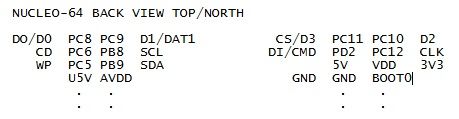

Hmm, no signs of activity on CLK or CMD at all! I'm wondering if we have different IO assignments or something. It is a stock Nucleo-L476RG without an HSE (X3 not loaded). The IO assignments for the SDMMC I have are: CLK PC12, CMD PD2, D0 PC8, D1 PC9, D2 PC10, D3 PC11. I used ST-Link to program the hex file and it verified OK. Besides the wires to the SD card reader, the only other hardware are the 5 47K pull-ups on DAT and D0-D3.

Wiring from the back side
Clive:
I had some other priorities for a few days, but back on it now. I had the SDMMC wiring right, but stuck on the console without some further information. I guessed at USART2 given that is what is connected to the Arduino pins, but see nothing and blindly pressing ENTER with a few baud rates didn't work. I looked at several of the alternate pins for USARTx_TX pins and don't see any data coming out at any baud rate. Studying your pictures doesn't show any wires outside the SDMMC pins either. Can you tell me which pins for the USART (assuming it is USART), and baud rate?
