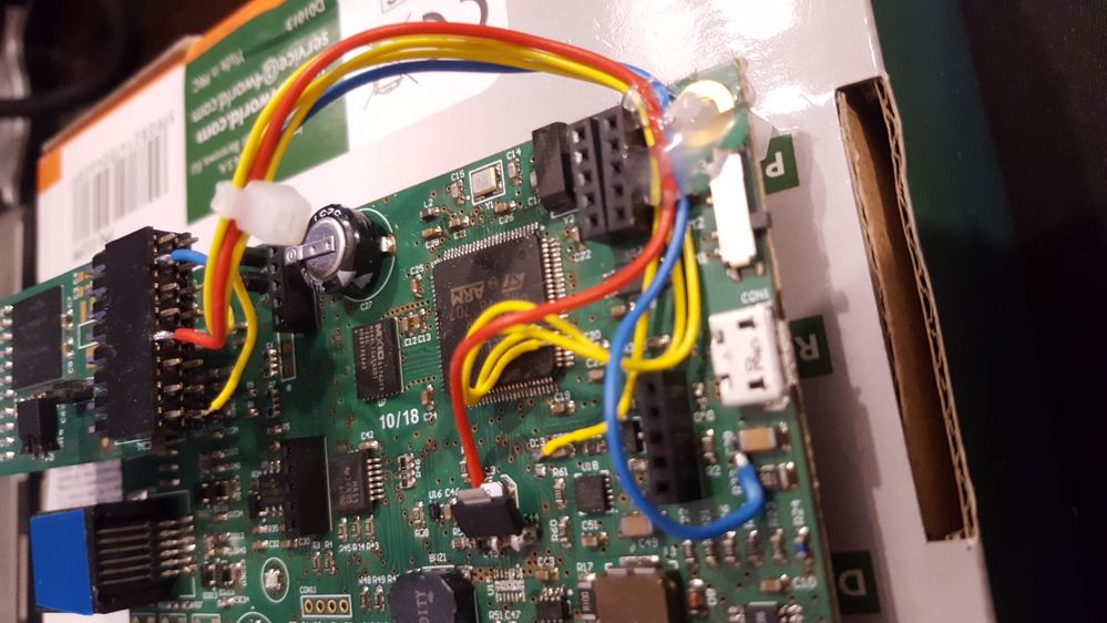

Sky-wiring is tricky. To me it is only good for some basic verification work and not much beyond that before going to a board. Even at slow speeds, if the transitions are high speed you can still get ringing. My wires are quite a bit shorter and looking at the signals with my scope show that they are far from clean.
Being able to get 17Mbps with this far-from-ideal setup just gives me confidence that once I go to a PCB with a ground plane and both series and pullup resistors to get clean signals, bandwidth can only go up. My test was with 24MHz divided by 4 (6MHz) too, but was able to get 4-bit mode working. If you have a scope, might be worth checking D1-D3 to see if maybe something is obviously not-pretty.

Hi Will,
You are right, my cables are really bad. But at this point, i need it to work at any speed and with any data signals. Also, I was able to use 4 data bits thanks to Clive's help on a Nucleo board. Just could not bring the rest 3 signals to my current PCB because the pins are already in use by other peripherals. I am also looking forward to the next pcb revision, with series resistors and 4 data lines.

they are very thick wires, do you have any wirewrap wire ?

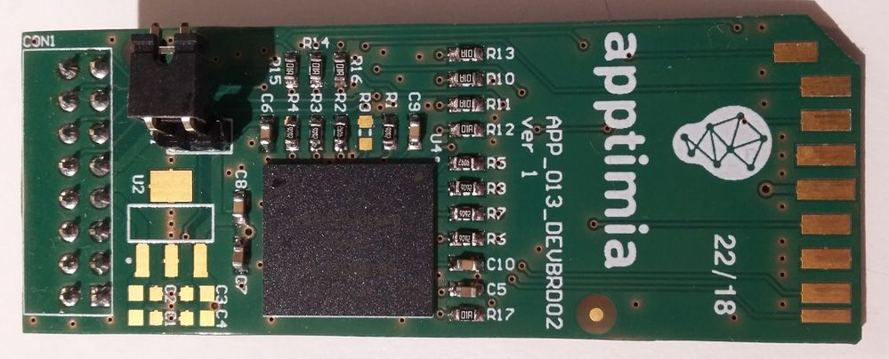

too hard to retro fit... which eMMC chip are you using ?
I can whip up a daughter board for you...
Attaching the test app for SD card on NUCLEO-L476RG, outputs diagnostic and menu on VCP at 115200 8N1
This was Lukasz's eMMC dongle for the NUCLEO-144 boards, also readable using a full size SD Card socket, which is what I was using today on the NUCLEO-64
