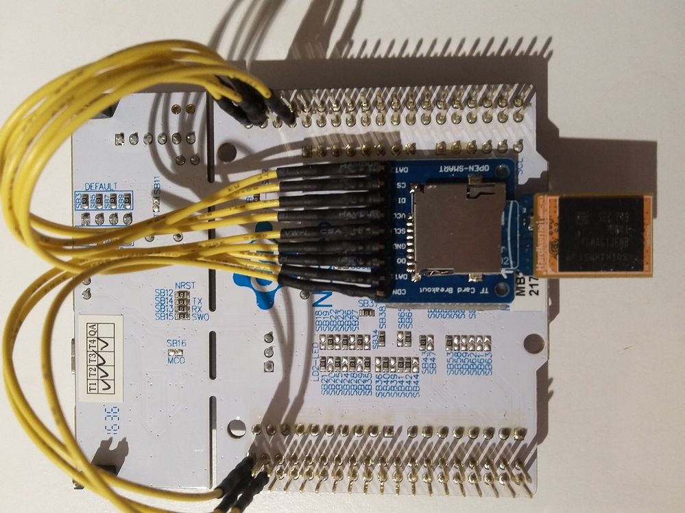

I did confirm that the port to the NUCLEO-L452RE was working.
With a 25 MHz clock read of the eMMC was 10.1 MBps, at 50 MHz 17.8 MBps

Given that polled mode works (and works in 4-bit mode too), I've not been looking too much for hardware issues. It would be a bit embarassing (but good) to find out it is a hardware issue of some kind. It is literally just eight wires with 47K pull-up resistors on CMD and the four data lines. No pull-up on CLK. That follows the example I've seen in some demo board schematics. I do have a scope, but just a 2-channel one (Tek TDS-210 60MHz). Signals look pretty good. There is a bit of ringing, but not bad enough to worry about.
