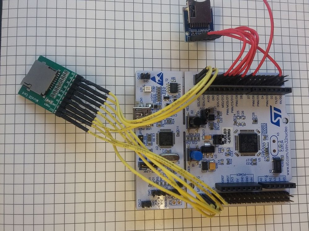

The board I got a while back was the Adafruit one that had an SPI-wired SD card and LCD to warm me up for another project for which SPI-based SD card comms was fine. They are handy. For this test I already had reader sockets left over from that project so opted to just sky-wire it (see picture in post to Clive below). I didn't have pullups on any lines after reading some posts saying they wern't necessary. Seeing scope traces made me wonder. It took a couple days to get to the right combination of pullups plus non-DMA to finally see things working. I'm getting there, just taking a bit longer than I had expected.

That is some serious speed. My sky wires are even shorter (see picture) and I was seeing some not-so-great signals and errors at 24MHz. I'm not terribly worried just yet, I'm sure a good layout will help considerably. That is good to know, though.

One can certainly do a much better job with a PCB design. The trace lengths on some of ST's EVAL boards are longer than I'd like. @Community member​ is working on some socket dongles for the NUCLEO-144 series that plug in compactly on the back-side. @Community member​ made a eMMC dongle when we were working on that.
Keeping trace lengths short and equal is desirable. For short runs, 27 or 33R series resistors should be used to stop ringing (backing off slew rate also helps), and 33 or 47K pull-up at the socket for the data and command lines.
In retrospect I should have used the shorter schmartboard wires for the SDMMC rather than the SPI, but it photographs well, works well, and can be handed around a conference table without getting broken, or in a car ride to/from home in a box. I've used wire-wrap a lot in the past, and that is more reliable than the dupont wires people use for bread boarding.

The jumper set I have doesn't look as nice as those. Wire wrap has worked well for me and I stockpiled a lot a long time ago, so still using it! If I can use jumpers I do, but often the thing I'm trying to wire up doesn't have posts like the SD card connector, so wire wrapping one end and soldering the other works out nicely. The hardware guy in me says use series resistors for slew rate control, but probably should listen to the firmware guy and use built-in slew rate control of the micro! :)
