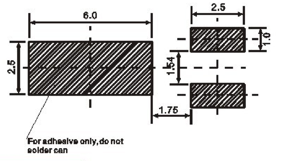

2018-03-14 2:31 AM
The datasheet states that the can should not be soldered, but only glued:
Mazur.Grzegorz
could you please elaborate on what did you mean exacly to solder the case?2018-03-14 6:06 AM

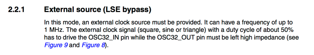

I was reading today an ST document about hardware design and I got into this:
What about using a MEMS oscillator like this
http://www.abracon.com/Oscillators/ASTMKJ.pdf
to get rid of the crystal circuit tuning mess? Did anyone tried this approach?
