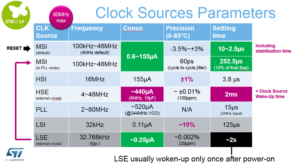

Hello JLuc,
Please find extract from STM32L4 training material related to clock sources parameters, including their accuracy.
Regards
Szymon
