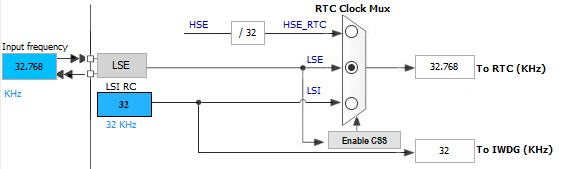

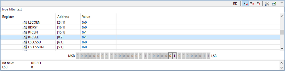

Check (read out) respective RCC register (RCC_BDCR.RTCSEL) whether you are clocking RTC from LSE indeed.

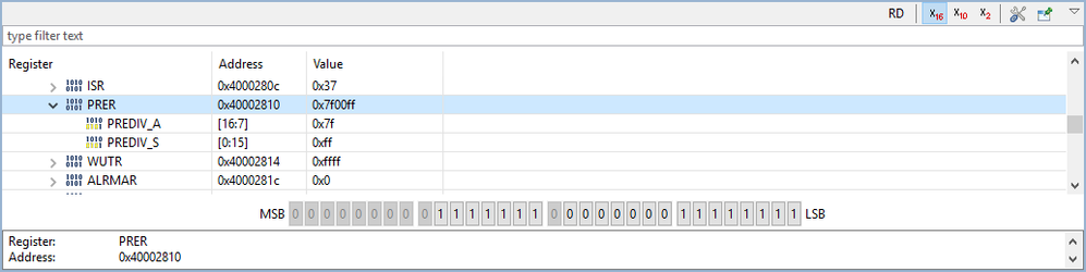

Check (read out) the RTC divider registers.
Checked:
Checked. According to this its fine:
Yes I am using HSE. Could you please elaborate more on what am I exactly to do?

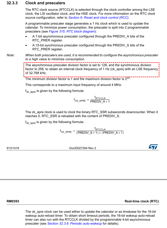

The red outlined portion could be confusing it defines PREDIV_A as 127 (128-1), and PREDIV_S as 255 (256-1), allowing the Fck_spre formula to be correct.
abs25-32.768khz-6
http://www.abracon.com/Resonators/abs25.pdf

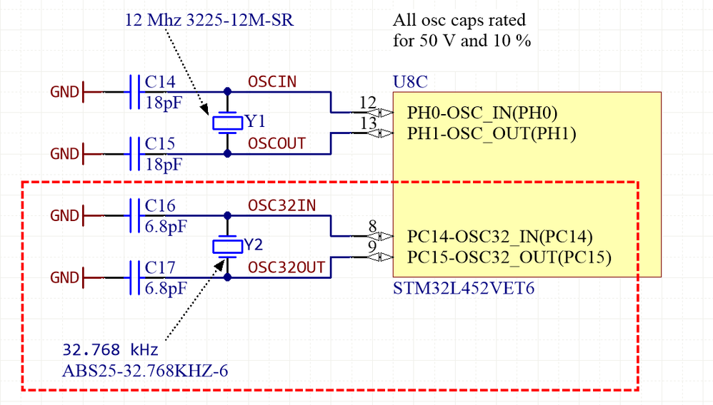

Are we sure the 6.8pF capacitors are actually suitable for a 6pF crystal? Would these need to be closer to 3pF? You've specified the 6pF part not the 12pF one. If you screw up the loading it is likely to be off frequency.
Would strongly recommend pushing the LSE out of MCO (or whatever works on the L4) and measuring with a calibrated precision frequency counter, or clock HSE from a ppb source and measure with the TIM internally.

I will check the caps tommorow. I could also push the LSE on a pin and measure the frequency with a scope (if thats possible). Thanks.

Don't bother - crystals pull ability isn't going to be remotely close the kind of errors you saw here.
I would make sure that the etc is set up right first. Then the right clock is used, then the crystal is the correct one / working, and then your code is correct - you aren't writing to the etc incorrect values, ....
