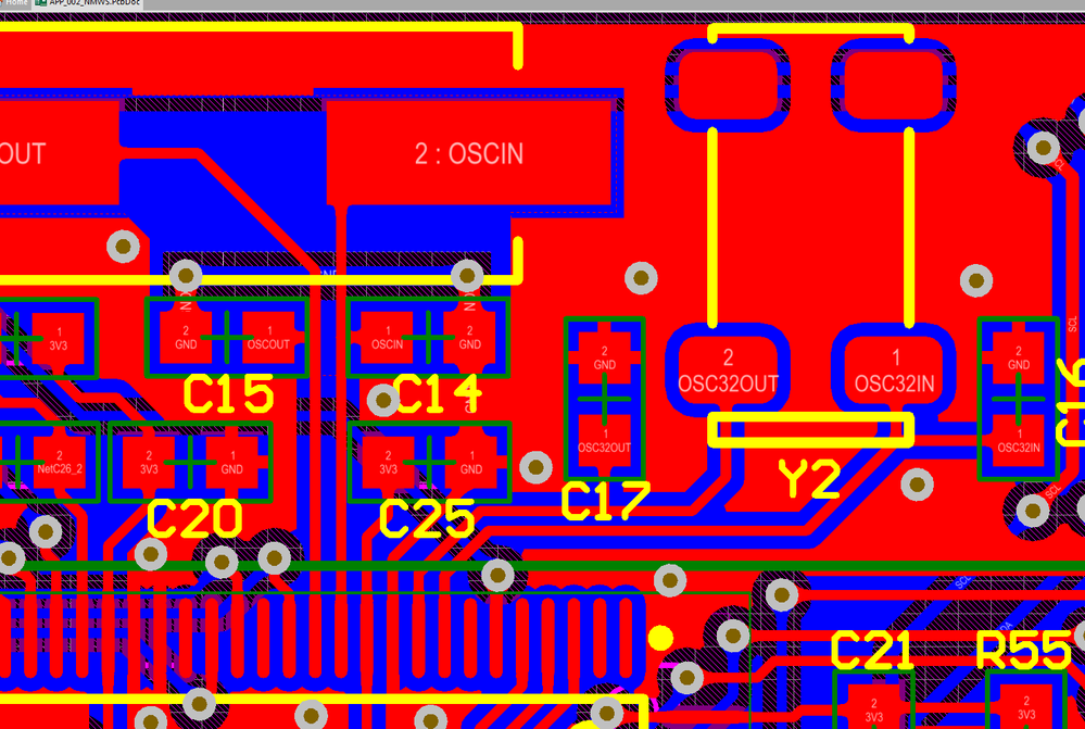

Thank you for answer,
To answer your questions, here is screenshot of how the crystal is routed:
Its the Y2 crystal.
I would not say that your guidelines were followed. I paid a lot more attention to the HSE placement to be fair, as I thought at this frequency (32 kHz) there are not hard constraints when it comes to placement. This is a 2 layer board so the is no solid GND plane underneath the crystal. Do you really think that this could make the difference?
2018-03-11 6:29 AM
If
Mazur.Grzegorz
is correct, you have noise injection from the ground fills, from the switchers.I would remove the ground fill from the crystal circuit area totally and off C16, C17, try to move underside tracks away if possible.
Run a 15thou trace from C17,C16(Gnd), to pin 10 Vss, before it hits C25, then connecting to the remaining ground fill/track.
This will mostly block any switcher noise you have propagating along Vss,.along your ground fills.
2018-03-11 8:05 AM
Your layout is not perfect but not bad. I would try to move away the tracks crossing LSE tracks and slightly move the capacitors. I would suggest to try another oscillator, 'straw' thin can 'watch' type and ground its case. The black plastic one you use is the worst one for L4 (I did the same, so I know) . Try 6p8 capacitors and LSEDRV options. The LSE tracks should ideally go through the LCE capacitors to the oscillator.
2018-03-11 1:27 PM
I will try another oscillator in the next revision, thanks. About the caps in the way of routes- I find it hard to measure either this really makes sense at this frequencies. Also, its not good reflow oven soldering wise.
