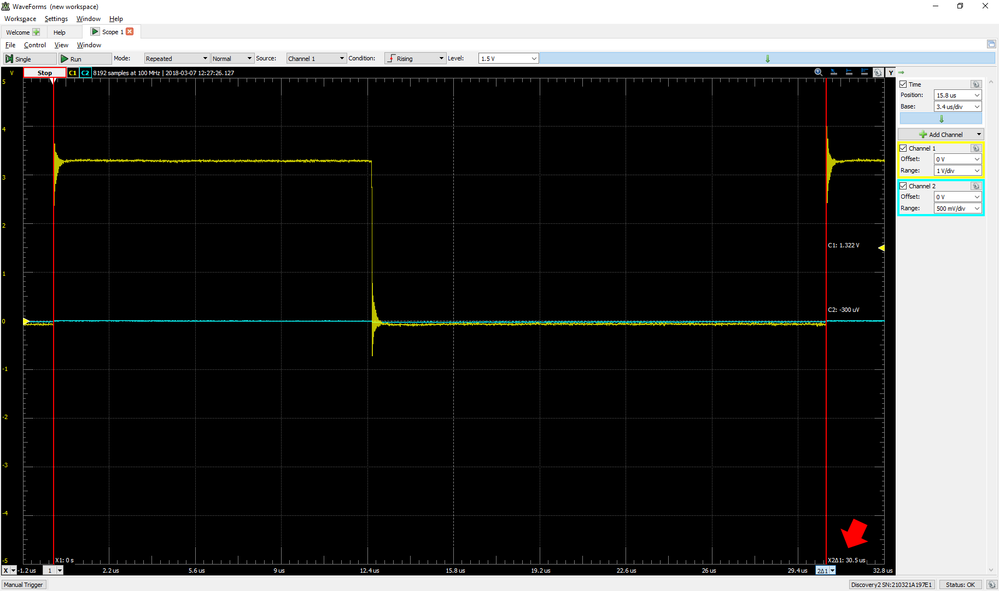

So I have the scope view here:
The time for a full period is ~3.5 us, which gives 32786,8852459016393442623 Hz. I think that it is correct. I am not sure however why is the MCO output PWM not 50 %.
Can the crystal frequency be ruled out as a problem ir is the measurement not precise enough?

3.5us period means a frequency just shy of 300khz. Something is seriously wrong here.
Those crystals have a pullability of about 0.5hz per pf. So they cannot possibly account for a material portion of your error here.
2018-03-07 6:47 AM
sorry, its a mistype in the post. Its 5 us, not 3.5 us. That gives the proper frequency.
