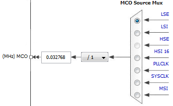

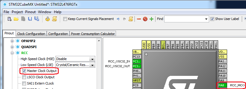

Hi Lukasz,
In order to output LSE on the pin please use MCO - Master Clock Output. Typically it is PA8. You can enable it in Pinout tab of STM32CubeMX like this:
Then please move to Clock Configuration tab and select LSE as a clock source for MCO:

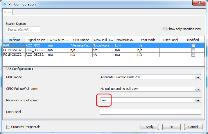

Regarding pin configuration, please keep default slope setting, which is low:
After connecting PA8 to the scope you will see shape and frequency of the LSE.
Regards
Szymon
