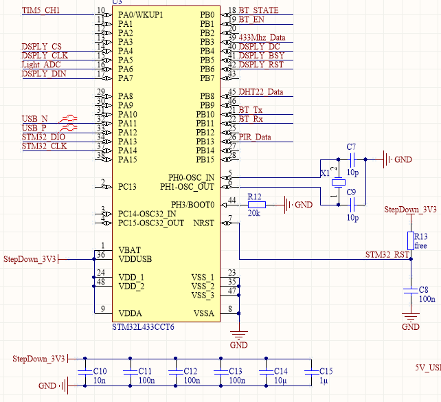

My schematic is attached. You can ignore the other GPIO Pins. I haven't connected them yet.

Do you really have no decoupling capacitor at VDD? Then expect any kind of strange behaviout. And those decoupling caps should connect VDD/VSS with short wires! nRST at the STM32 also has an internal pullup, R13 may be contraproductive. Remove it. C8 should also connect nRst to GND with short wires.

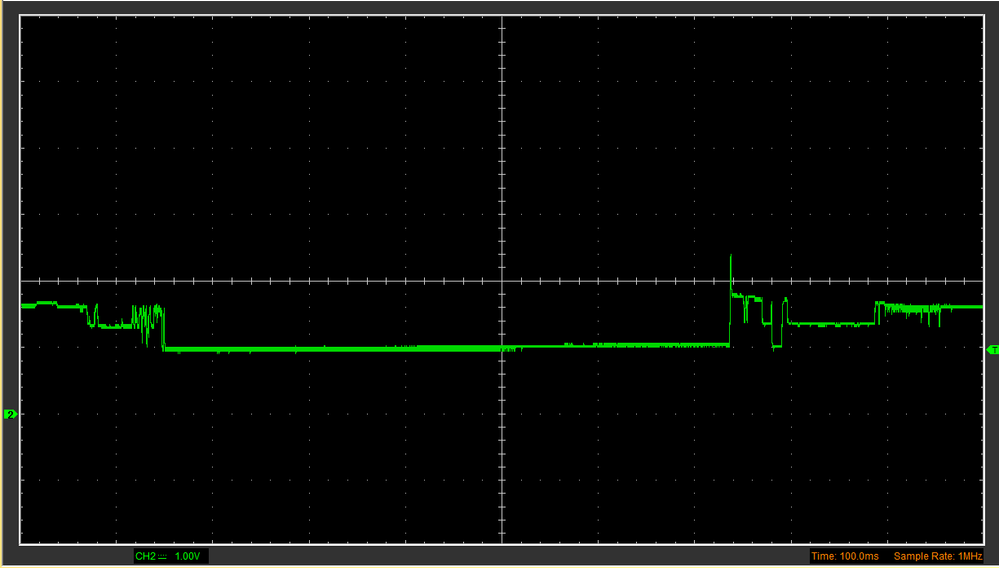

Observe the NRST pin using an oscilloscope.

Some dancing NRST signals are attached.

Thanks to all who helped me! Here the circuit of the working µC (The capacitors are placed as close as possible to the µC):

as you can see in this thread, I had to place decoupling capacitors very close to the µC.
You can also have a look at Getting started with STM32L1xxx hardware development. Have a look at page 10. There is the power supply scheme with all decoupling capacitors needed.
