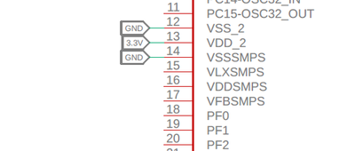

- CubeMX power mode: PWR_DIRECT_SMPS_SUPPLY.
But according to your schematic, SMPS is almost not connected.

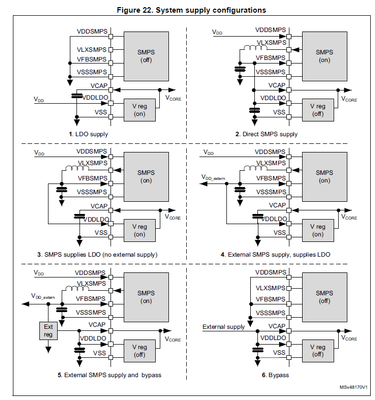

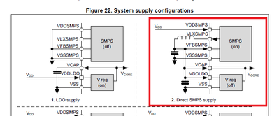

From the RM0399 / figure 22, this is the hardware configuration for the direct SMPS:
The question is, how did you design your board? did you refer to any reference design?
NUCLEO-H755 board schematics for example?
The following are the different HW power config listed in the reference manual. Did you refer to the documentations: reference manual, the datasheet or the AN4938 before starting your design?:
