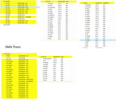

Hi, Thank you, UART_CIRCLE_MAX_BUFFER_SIZE > 1 (for now I tried = 60). Registers bellow:

Clear the overrun issue.
Identify why you aren't monitoring receiver continuously (probably when it's not in the blocking function), and implement identification and clearing of errors like Overrun, Noise, Parity, Framing which will block reception until explicitly cleared.

If ORE is set, does it means the DMA does not read the RDR and pass t to the GlUartRxBuffer?
I want the DMA to read every received byte on UART1 and store it in GlUartRxBuffer - and do this in circular mode, without any interrupts.

Suggests at some point you weren't servicing it.
Large circular / continuous DMA shouldn't miss data, but might get other errors that need to be cleared, say the lines glitched, or baud rates changed, cables connected, etc. DMA perhaps best serviced in HT/TC interrupts, or data periodically harvested.

As far as I know, DMA should be able to automatically transfer data from RDR to memory (globalBuffer), and in my case, Circular mode should start over from index 0 if it reaches the end of the buffer. I think the registers for this are set correctly, but I must have overlooked something.

I spent some time trying to track it down but didn't see any red flags.
It's odd how NDTR is 59, and the DMA stream is still active. Like it transferred one byte and stopped, as you say.
It is not a mystery why more bytes are not transferred--ORE needs to be cleared.
Perhaps ORE was set prior to the DMA being enabled, so one byte was immediately transferred (as RXNE=1) but no more as possible (due to ORE). That's my best guess. Easy enough to check. But at 9600 baud and with the code you presented, that shouldn't be happening. Perhaps there is some other code which blocks.
If ORE is set, the DMA doesn't know that and keeps running. It's the UART stops receiving - you need to detect and clear ORE to let it go. Newer STM32s have option to disable ORE so it never occurs at all (TL;DR but this has other complications).
