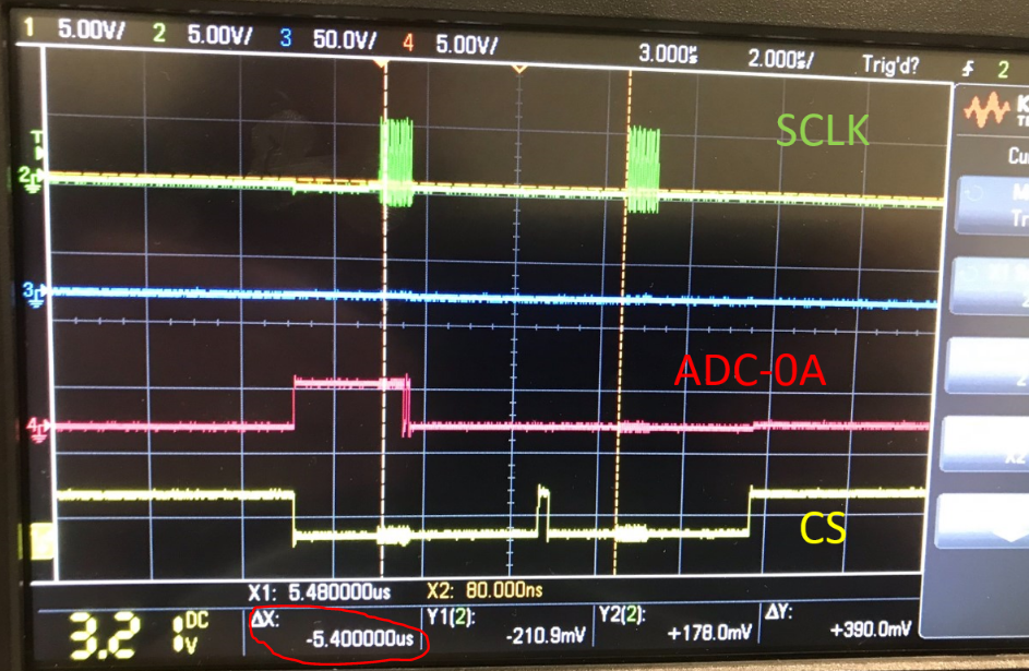

I am using the NUCLEO-F446RE with the STM32F446RE. I am trying to interface with an external dual sampling differential ADC: ADS9224R.
ADC Timing Diagram
The ADC can provide samples at up to 3M/s. I would be happy to achieve ~0.8M/s sampling.
I have been struggling to meet the timing that I require and can only reach ~180kHz with the STM32. My problem is that initiating separate SPI receive calls takes too long between commands.
Running the following code to initiate back to back SPI reads:
HAL_GPIO_WritePin(GPIOB, GPIO_PIN_6, GPIO_PIN_RESET); //CS LOW
HAL_SPI_Receive(&hspi1, (uint8_t *)spi_buffer, 1,40);
HAL_GPIO_WritePin(GPIOB, GPIO_PIN_6, GPIO_PIN_SET); //CS high
HAL_GPIO_WritePin(GPIOB, GPIO_PIN_6, GPIO_PIN_SET); //CS highProduces the following timing:
The STM32 is operating at 180MHz, and the SPI CLK is at ~30MHz. You can see that once the SPI initiates it is very fast, but the time to initiate the next SPI read is taking too long (~6us) which is limiting the rate at which I can read from the ADC.
I understand that this approach will only read ADC-0A, and not ADC-0B simultaneously. I have an implementation that uses QSPI but suffers from the same problem. I have simplified to single line SPI in hope that more people can provide help and I can transfer this to a dual line implementation.
Thank you all for your help!

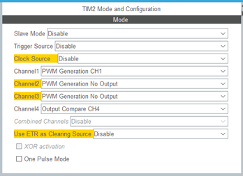

Ok, next plan, no code yet. If the 2nd SPI is slave, why not put both in slave mode (with circular RX DMA)? Then, we need another component, generating the clock pulses. This could be Timer TIM1 in one pulse mode and using a repetition counter of 7 (for 8 pulses). The pulse train (clock) is output in PWM GenerationCH1 mode.
How to trigger TIM1? Manually, for testing, worked.
Next: Automatically from TIM2. (Put TIM into slave trigger mode and route the TIM2 event to TIM1 ITR.

HAL functions seem to be a bit heavy for tight timing. You may have go down to register level. This is almost trivial for the GPIO but not so much for the SPI. You might also generate low level (LL) code which is close to register level prog.
ADC sampling usually requires a low jitter. So triggering by software might not be feasible at all.

Thanks for your help. I understand that this is not deterministic, but I was trying to produce the lowest possible timing by executing the HAL commands back to back, without having to handle the interrupt of a timer to potentially slow down the execution.
Would DMA speed up the operation, because the CPU does not need to handle writing the buffer to memory between each SPI receive call, allowing the next SPI call can be initiated sooner?
Is the timing I require actually realistic for my processor? I have not worked at these data rates before, I thought having to read an external ADC with SPI at ~1MS/s would be a reasonably common application.

The timing you require is possible, but not realistic with HAL. The synchronization of the CS line provides an additional hurdle, unless you can keep it low.
As KnarfB says, triggering the SPI from a timer is your best bet here. You'll also need a DMA channel to read the incoming data.

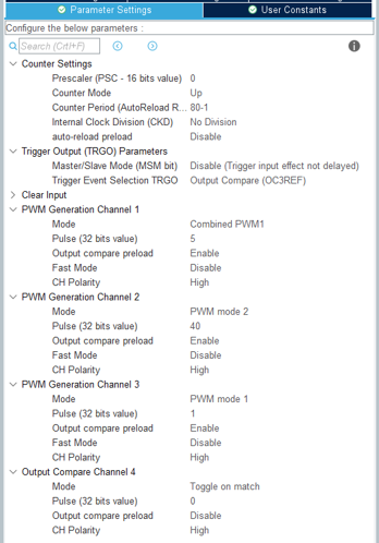

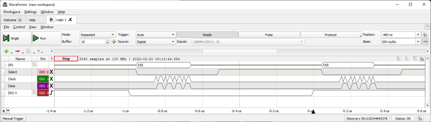

here is an example, but its for another MCU (STM32L432KC @ 80 MHz SYSCLK) and writing SPI bytes @ 1 MHz by DMA under control of timer TIM2. Timer config:
Yellow - conflict warnings for that Nucleo board, can be ignored.
Timer runs at full speed with 80 ticks/µs.
Channel CH1 and CH2 generate the CS signal. CH1 the first, falling edge, CH2 the 2nd, rising edge. Edge positions can be freely configured as needed by their pulse values.
CH3 trailing (falling) edge triggers next byte to be sent. This is not fully done in the config but in the code.
CH4 is only a trigger for the attached LA. It toggles at each µs (timer overflow).

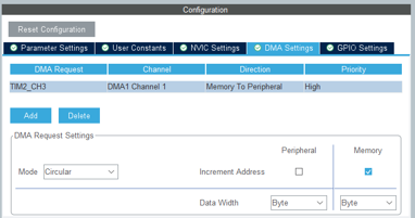

Cyclic DMA config in TIM2 tab:
Code in main() before (empty) main loop:
HAL_DMA_Start(&hdma_tim2_ch3, (uint32_t)buffer, (uint32_t)&(SPI1->DR), 1);
HAL_TIM_PWM_Start(&htim2, TIM_CHANNEL_1);
HAL_TIM_PWM_Start(&htim2, TIM_CHANNEL_2);
HAL_TIM_PWM_Start(&htim2, TIM_CHANNEL_3);
HAL_TIM_OC_Start(&htim2, TIM_CHANNEL_4);
__HAL_SPI_ENABLE(&hspi1);
__HAL_TIM_ENABLE_DMA(&htim2, TIM_DMA_CC3);HAL_DMA_Start sets src and dst addresses. Destination is the SPI1 data register. Each write to it generates a SPI transfer. Then the timer channels are started, SPI is enabled and finally the DMA trigger.
Output:

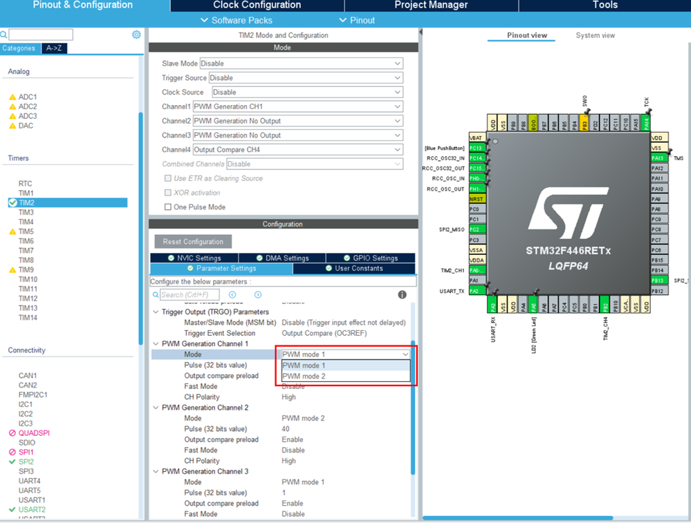

I have been trying to set up the TIM2 peripheral to match your screenshots within the CUBEIDE, however I am missing the "combined PWM1" mode for Channel 1. It only lets me select "PWM mode 1" or "PWM mode 2", as shown below:
Selecting PWM Mode 1 instead, produces an output on PA0 (TIM2_CH1) that pulses high for 0.1us every 1us. Changing the pulse parameter for channels 1 and 2, do not change the waveform. Is this because the "combined PWM1" mode was not used for Channel 1?

2022-02-21 9:04 AM
Ooops, combined PWM is not avail on F4. But, we don't really need it here. Normal PWM Mode 2 of a single channel, say CH1, yields a CS pulse (low active) starting at counter value 0 and ending at the programmed pulse value. You may then shift the value of the DMA triggering channel (CH3) a bit more to the left and should get the same timings.
