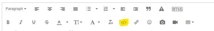

Use code formatting as it makes it easier to read code
