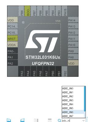

2025-12-03 6:30 AM
CubeMX can highlight pins for you. This information is also available in the datasheet.
Here are the 10 pins with ADC capability on this chip:
