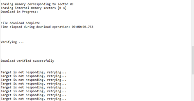

Although the application is successfully stored in external flash, when I try to execute it via memory-mapped mode, it fails (shows “Target Failed” or halts). I’m not sure whether it’s due to memory mapping, stack configuration, MPU, or something else.

Problem / Clarification Needed:
After jumping to the application, am getting below issue.
