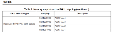

2026-02-23 7:18 AM
Hello @siddum ,
1. Do you run a secure or non secure project? (We do not provide any non secure project with N6, the TBS we have on TouchGFX are secure and using AXISRAM secure memory ranges).
2. Do you run "eXecute In Place" or "Load and Run" application?
3. Are you sure your screen is correctly configured and can show pixels? (without TouchGFX)
2026-03-11 12:00 AM
Hello @Osman,
Thank you for the clarification.
Project type:
We are running a secure project. And we are using secure configuration with AXISRAM1 secure memory(0x34000000) as framebuffer address .
Execution mode:
Our application is running in Execute In Place mode.
Display verification:
We are currently not using TouchGFX. We are trying to verify the display through LTDC configuration directly.
The LTDC initialization code/configuration is attached below for reference.
We can see the framebuffer data correctly updating in the memory window, which indicates that pixel values are being written to memory. However, the RGB output signals from the LTDC are not active, so no data appears on the display.
Kindly let us know if there are additional configurations required to enable the RGB output or if any clock or LTDC settings need to be verified.
