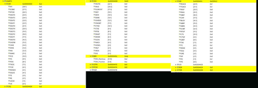

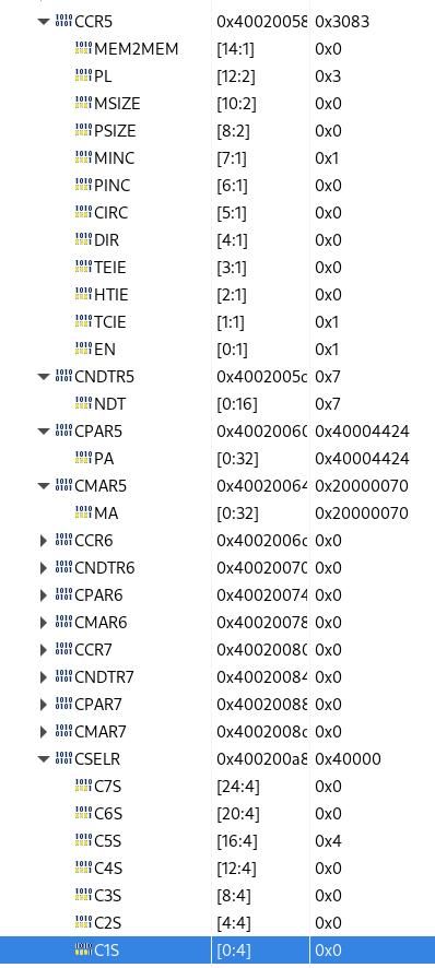

2024-11-14 11:02 PM
Read out and check/post DMA and UART registers content.
2024-11-16 9:57 PM
That was a good suggestion. However, I am still not seeing the reason why the code is not receiving incoming data. I must still be a setting with DMA.
2024-11-17 12:29 AM
I don't see any problem here.
Is this *after* data have been arrived at the UART's Rx pin?
What are the UART registers content after that? (note, that you should not observe those registers permanently in the IDE, due to reading UARTx_RDR by debugger clearing the RXNE flag).
2024-11-17 5:59 PM
Are there any specific register values that I should be looking for? If my DMA settings look correct, then maybe I do need to take another look at my USART code.
-A
