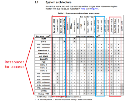

The answer is given in the RM0399 / Table 2. Bus-master-to-bus-slave interconnect
ETH and SDMMC are masters like Cortex-M7 and Cortex-M4 and you can use ETH and SDMMC either on Cortex-M7 or Cortex-M4 but you need to ensure that the shared memory between ETH/SDMMC is accessible by the Cortex-M. For that you need to check that in the table above.
