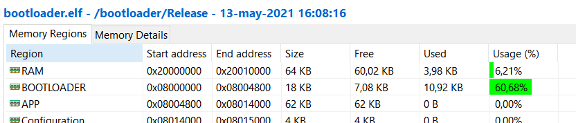

My jumptoAPP function from the bootlodaer looks like this;
void jumpToApp(const uint32_t address) {
const JumpStruct *vector_p = (JumpStruct*) address;
deinitEverything();
/* let's do The Jump! */
/* Jump, used asm to avoid stack optimization */
asm("msr msp, %0; bx %1;" : : "r"(vector_p->stack_addr), "r"(vector_p->func_p));
void deinitEverything() {
//-- reset peripherals to guarantee flawless start of user application
// HAL_GPIO_DeInit(LED_GPIO_Port, LED_Pin);
HAL_GPIO_DeInit(CAN1_TX_BOOTLOADER_GPIO_Port, CAN1_TX_BOOTLOADER_Pin);
HAL_GPIO_DeInit(CAN1_RX_BOOTLOADER_GPIO_Port, CAN1_RX_BOOTLOADER_Pin);
HAL_CAN_DeInit(_hcan);
HAL_RCC_DeInit();
HAL_DeInit();
SysTick->CTRL = 0;
SysTick->LOAD = 0;
SysTick->VAL = 0;
