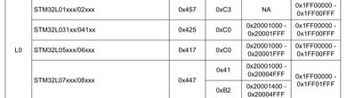

Dear @Robin_Iddon ,
Your observation is correct and is mentioned in AN2606 here
so All RAM zone will be Nacked by any Write /Read or Go command on STM32L011 devices.

Dear @Robin_Iddon ,

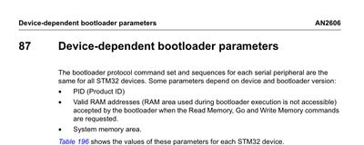

Thanks - we use L03x for some of our code development and had lost track of the fact that the L01 has only 2K of SRAM!
It would be nice if that was more clearly stated in the other sections of the manual ... it's easy to lose track of which parts have only 2K and which parts have more SRAM. For example on page 289 in the L0 SRAM section where it shows 2K are used by bootloader, it could say "see Table 196, L0 section, to determine how much, if any, SRAM is available for user read/write."
