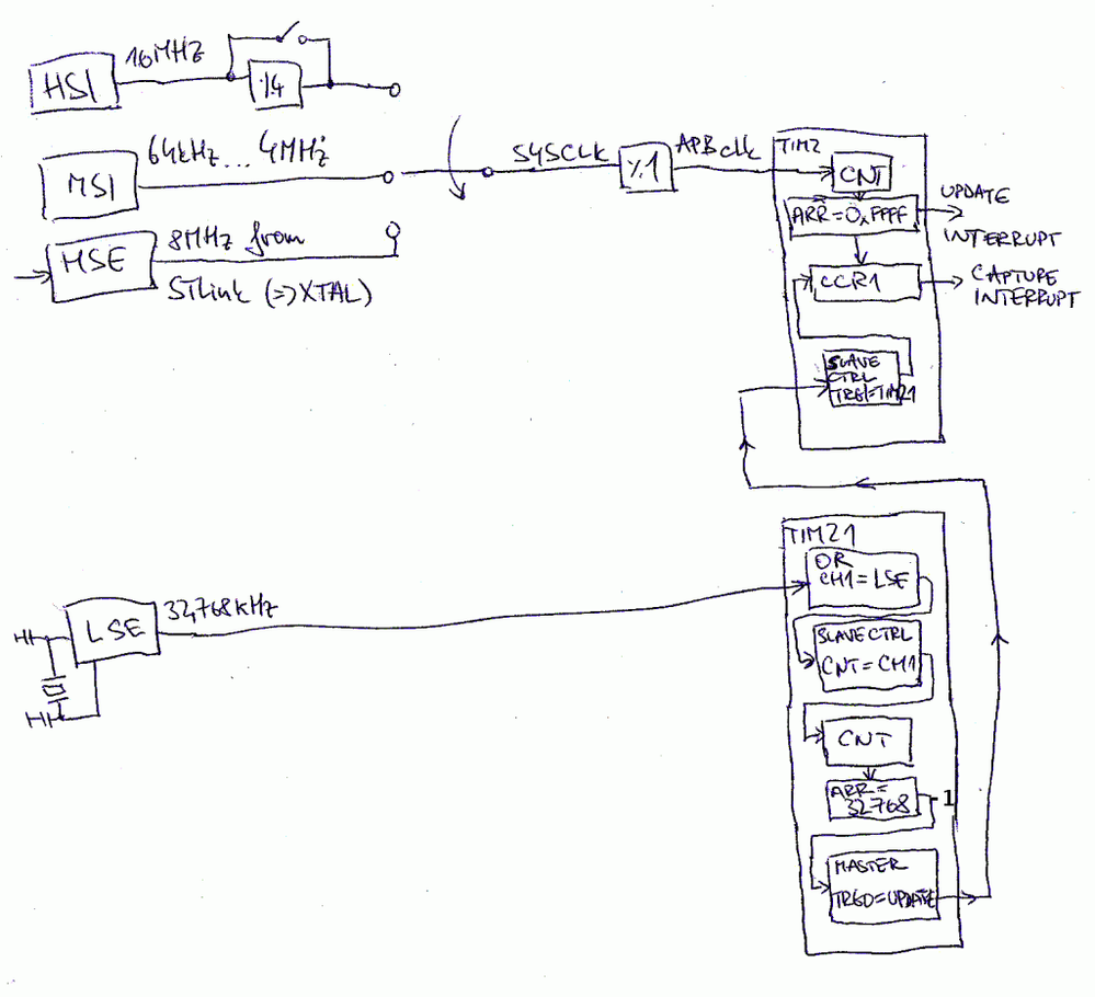

http://www.efton.sk/STM32/timchain.zip
is a demo (based on the L053 DISCO, with installed 768kHz crystal) of what should result in as precise measurement of the MSI/HSI-vs.-LSE as it gets, purely in hardware, with no software influencing the precision:The 16-bit limitation of TIM2 is mitigated by counting overflows in the update interrupt (and accounting for the case when overflow happens after capture but before the status register is read).
The findings for both HSI16 and MSI are - unsurprisingly - that they permanently fluctuate up and down hundreds of ppm, around a center offset from the nominal by tenths of % (except the MSI at its lowest setting of 64kHz, which was wildly off).
The example is barebones, written for gcc, using only the CMSIS-mandated headers (to be extracted from CubeL0). Results are simply written to memory, to be observed by a debugger.
Enjoy!
PS A similar thread
https://community.st.com/thread/49041-rtc-calibration-stm32l011g4
2018-04-15 7:34 PM
It was wildly off because the STM32 timers are strictly synchronous (except LPTIM, but that isn't linked), channels have an edge detector at their front-end thus edges of the 32kHz LSE signal at the input of timer clocked at around 64kHz sometimes simply got lost...
I tweaked the code so that TIM21 CH1 OR is set to MCO, and MCO is set to LSE div 2, and it works as expected, but is not in the published version yet.
