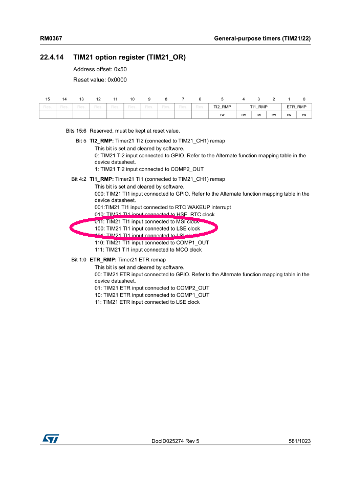

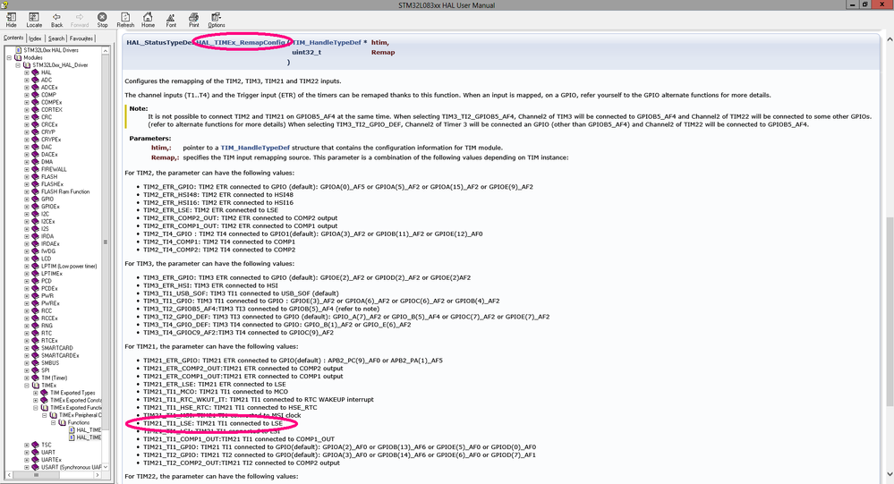

I don't use CubeMX so I don't know how to click it in there, but it's only about setting the TIM21_OR register.
Looking into Cube's sources, this should be the incantation to use:

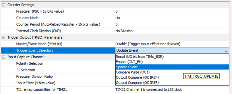

Well, I was able to associate the LSE clock source to channel 1 of the timer,
What do you think about that? are there better strategies to get the result? I thank you very much

You don't need that second step, setting TRGO - that would be used if you'd want to link internally some other timer to TIM21.
The method is roughly correct - in the interrupt, you count up to 32768 and then read out the capture register (TIM21_CCR1) to find out the number of HSI ticks. This all is assuming there is no PLL used and there is no divider on the APB buses.
