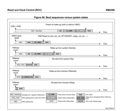

Can anyone help or provide me the boot sequence diagram of STM32H755xI which has dual-core (M7 and M4)?

Are you looking for this diagram:
If not, all available boot diagram you may find on the application note AN2606 or the RM0399.
