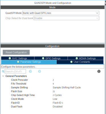

My QUADSPI configuration:

Which STM32H7? Does it have Octo-SPI or only QSPI?
2024-08-04 12:34 AM
STM32H753 - have only QSPI
2024-08-04 2:10 AM
QSPI cannot write in memory mapped mode, as you probably know.
