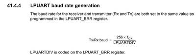

BRR seems wrong. See formula in the RM. You're setting it as if there are no fractional bits. Should be 256x what you have.

LPUART1->BRR = ((256 * SystemCoreClock) / 9600);

}Upon starting screen on my computer the same way as before, I get a stream of ">" characters whenever I press the button on the board. I tried changing the char sent by the board to 'r', which changed the character appearing in the terminal to a stream of "�" preceeded by a single "0". I thought this was due to a mismatch between the frames that the tty was expecting and what the board was sending, so I fiddled with stty options by "stty -F /dev/ttyACM0 -cstopb -parenb -clocal cs8". This sets the tty to expect the same as the default LPUART registers - 1 stop bit, 8 data bits, no parity bits. This didn't change anything, however :) I'm left thinking that my baud rate must still not be set correctly, but I cannot see what would be wrong (after correcting the error that @TDK pointed out).
