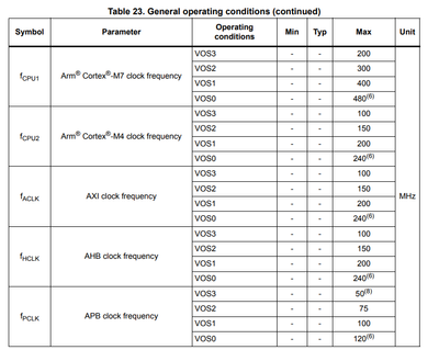

As can be seen, the MCU can reach up to 480MHz in the core M7 and 240MHz in the core M4.
After months of develpment, a firmware package update blocked me the VOS0 and VOS1, and in fact reading the user manual those modes are unavailable on my package, so i reduced to 300MHz and 150MHz

And in fact by reading the datasheet APB4 is limited to 100MHz.
Reducing APB4 to 100MHZ could not be a big deal, but the real problem is that considering the clock distribution in the previous image the clock of the APB4 is the same clock of the M4 (CPU2).
Does this means that i bought a 480+240MHz and i'm forced to use it at 300+100 after more than a year of development?

M4 and M7 can run at the same frequency with no problem, BUT:
If you use the M4 at 200/240 MHz (VOS0/1) you can use the M7 at 400/480MHz, no point of reducing the clock of the M7 at its 50%;
If you use (VOS2/3) The M7 can be used at 200/300 MHZ BUT the M4 cannot reach more than 100/150 MHZ, no reason to reduce the M7 to 100 MHz even in this case..
This is the "limitation" in your documentation, the VOSx settings. You are allowed to use the same frequency, but is meaningless.
