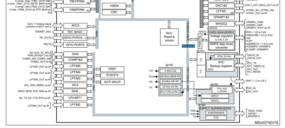

And in fact by reading the datasheet APB4 is limited to 100MHz.
Reducing APB4 to 100MHZ could not be a big deal, but the real problem is that considering the clock distribution in the previous image the clock of the APB4 is the same clock of the M4 (CPU2).
Does this means that i bought a 480+240MHz and i'm forced to use it at 300+100 after more than a year of development?

@STOne-32 My problem is not the reduction from 480 to 300 MHz due to the VOSx settings, but the new limit in the APHB that blocks the CPU2 from reaching frequencies allowed by the current VOSx settings, limiting it from a theoretical 240Hz to a maximum of 100MHz.
2024-02-13 6:17 AM
Not sure the plumbing is consistent with how it used to be.
APB4 used to be fractional from the AHB clock (M4 CPU), so M7 400 MHz, AHB 200 MHz, APB4 100 MHz.
Should be possible to get 150 MHz M4, with 75 MHz APB4 using the same relationships.

APB4 != AHB4
The M4 MCU runs at AHB4, the peripheral bus runs from APB4 at 100 MHz or below
2024-02-13 6:40 AM
Yes you are right, I confused AHB4 and APB4 but this not change the fact that CubeMX don't allow me to apply 150MHz, which now is also a value that can be used according to the datasheet.
Is a kind of bug? Or a limit?
