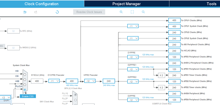

Today, with an update of cube MX, this error appeared in the clock tree:

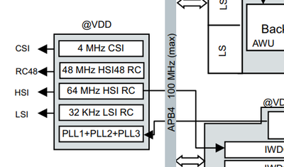

And in fact by reading the datasheet APB4 is limited to 100MHz.
Reducing APB4 to 100MHZ could not be a big deal, but the real problem is that considering the clock distribution in the previous image the clock of the APB4 is the same clock of the M4 (CPU2).
Does this means that i bought a 480+240MHz and i'm forced to use it at 300+100 after more than a year of development?

@AScha.3 I feel I'm going in circles. This is APB4, the M4 clocks from AHB4
On the V-Step devices, I could swear this should be 120 MHz for APB4, but the Data Sheet, Reference Manual and Website are a complete dog's breakfast of internally inconsistent information.
I'm also looking for some reason why the M7/M4 can't be clocked at the same speed for anything less-than-equal to 240 MHz, I haven't seen any stated reason why AHB4 can't be DIV1

Whatever it's worth - the full Cube clock tree picture for both CPUs, with max. values everywhere. All arrows without a divisor box are not configurable (1:1). Yes, Cube is not documentation, the manuals prevail...
