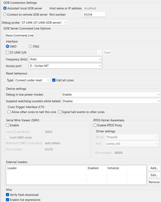

CM7 like this:

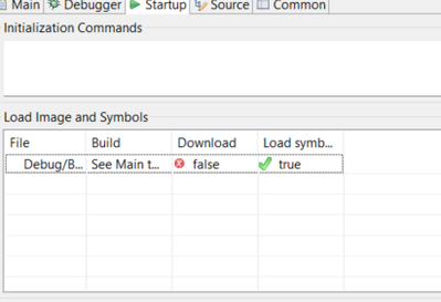

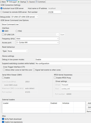

CM4:

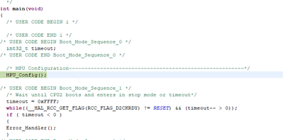

With that configuration when I launch CM7 first, then CM4, both pause as expected with CM4 in reset and CM7 ready to go. When I select both cores then click on the green go arrow, CM7 runs straight into this:
Caused by the timeout expiring.

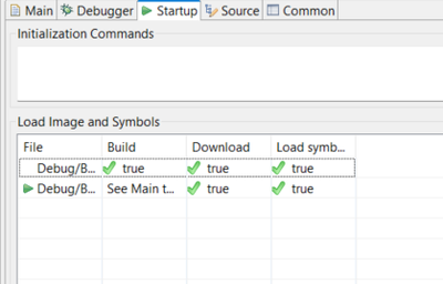

If, alternatively, I configure CM7 like this:
Then I can debug both cores, but they aren't doing a coordinated start as they should.

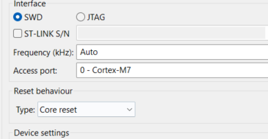

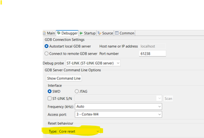

However, I have found that if I set the CM4 in the mode shown below then I can proceed without having to disable the CM7 timeout check:
I'm OK with this, since I have a solution that works.

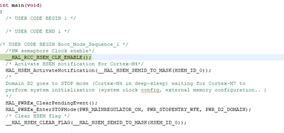

3. Start the M4 => it goes in stop mode
Here you get a dummy screen => don't give attention to the address given, just keep in mind that the M4 core in in stop mode.
