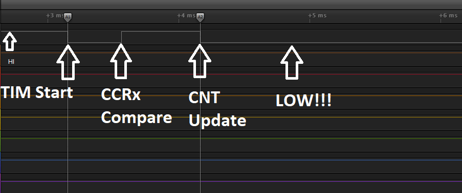

Need help, need to set PWM in a one pulse mode, so that at start timer there would be a low level output for a time equal to value of CCRx, after compare the output would be change to a high level and would remain so after overflow and stopping the counter.
Now I use PWM Mode 2 and active high level (tried PWM Mode 1 and active low level), as a result, after the counter stops, the output goes to low level, as shown on the screenshot:

Do I still need to set the channel as PWM mode for this?
In fact, I can't understand why there is a high level before the start timer, and a low level after the counter overflow, i.e. the timer tries to form the next period, but it is stopped and the stop occurs when the output is at a low level.

I mean, why when the One Pulse Mode is on, it hardware stops the counter and the channel outputs a low level (as you can see on the screen) and does not remain at a high level. Even the HAL function works this way...

I need the output to remain at a high level after the timer stops, but why does it become low, because before the timer started, the output was at a high level.

Before the timer starts, the timer is not driving the pin. It's probably set as high impedance and is floating high due to whatever is on the board. You can examine the state of the registers at this point to determine exactly why.
