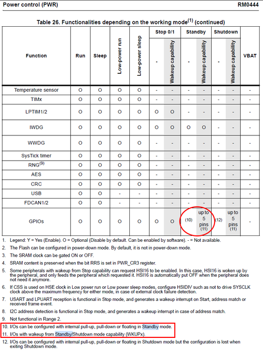

Table 26 in Reference Manual RM0444 (see below) seems to offer one of two (exclusive) possibilities:
  1. Without wakeup capability: wakeup pins are not available, but I/Os can be configured with internal pull-up, pull-down or floating. That would mean a GPIO pin can be assign 0 in Standby Mode.
  2. With wakeup capability: wakeup pins are available, but GPIOs cannot be configured and are floating.
Please confirm. Thank you!

Third option:
All GPIOs can be configured with internal pull-up, pull-down or floating. Out of those pins, 5 (6?) of them have an additional wakeup capability which can be used in addition to the pullups.

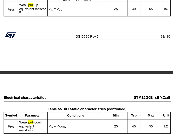

Pull is weak check pdf, typic around >15k. In standby only RTC pins can drive low.

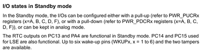

@MM..1you say that "In standby only RTC pins can drive low." Can you please point me to that in a ST doc?
Thanks again.
