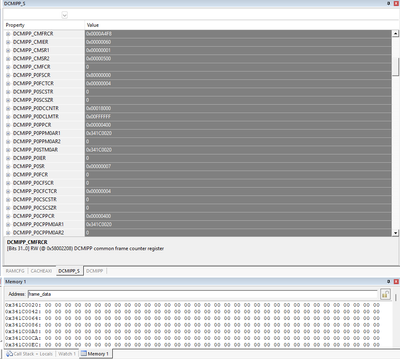

I am trying to setup DCMIPP Pipe0 to read data from 256x192 pixel sensor by 16 data lines.
Seems everything configured and working fine except of transfer data to destination buffer.
DCMIPP frame counter is increasing.
Pipe0 dump counter is 0x18000 (256x192x2).
HAL_DCMIPP_PIPE_Start return HAL_OK.
Pipe0 packer memory address register is qual to Pipe0 memory status address register and correspond to address of buffer in RAM.
I checked that DCMIPP don't write zero values by initing frame buffer with 0xFF and it wasn't changed to zeros.
I am sure that sensor is working because of frame counter, dump counter, checking lines with oscilloscope and it is working with other pcb with STM32H7 and DCMI interface.
Also I validated that debugger read frame buffer correctly by sending it thought uart.
Source code is simple, generated by cube init than I2C configuration of sensor(validated) and than reading in loop with delay:

2025-04-29 12:38 AM
Solved. It was problem with Resource isolation slave unit. Thanks to this post: https://community.st.com/t5/stm32-mcus-products/stm32n6-hpdma-not-copying-data/td-p/758276

Thanks so much for posting the solution Mike. This was the same issue I had with my N6 board. Camera was connected and working well with the default example, but when I tried to use the camera in my own example, it just wrote all 0s to the buffers.
RIMC_MasterConfig_t dcmipp_master = {0};
RIMC_MasterConfig_t eth1_master = {0};
dcmipp_master.MasterCID = RIF_CID_1;
/* The linked ST forum fix for the N6 raw-dump/HPDMA symptom configures DCMIPP as
* secure and privileged on both the master and slave sides. We mirror that
* here so Pipe0 follows the same isolation model. */
dcmipp_master.SecPriv = RIF_ATTRIBUTE_SEC | RIF_ATTRIBUTE_PRIV;
HAL_RIF_RIMC_ConfigMasterAttributes(RIF_MASTER_INDEX_DCMIPP, &dcmipp_master);
HAL_RIF_RISC_SetSlaveSecureAttributes(RIF_RISC_PERIPH_INDEX_DCMIPP,
RIF_ATTRIBUTE_SEC | RIF_ATTRIBUTE_PRIV);
