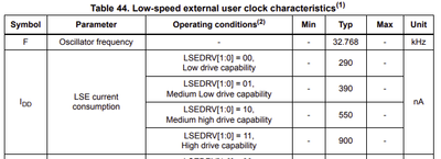

2025-04-09 1:35 PM
The only current parameter we give in the datasheet (for the silicon rev V) is the LSE current consumption on IDD based on the drive level:
