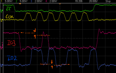

Did some tests yesterday and observed a strange behaviour, maybe the key to the status register auto-polling failure as already observed here Solved: STM32H753 QSPI Status Flag Polling fails with Inst... - STMicroelectronics Community
If the MX25 flash driver strength is kept to default 30Ohm, the polling is successful and timing looks like this:
Note the strange timing of the H7 in the first 2 clocks of the command phase.

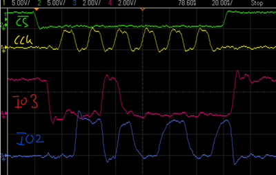

If set to 15Ohm (highest driver strength), the timing looks like this:
Note the strange behaviour of IO3 and IO2 in clock period 2.

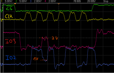

This does to appear on MX66 at 15 Ohm setting, too, but less effect:
At higher drive strength, the signals on IO2/3 are clamped. I cannot find this effect on IO0/1. Maybe this is a result of the special functions WP# / RESET# of pins IO2/3?
