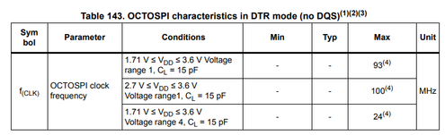

Which voltage range are you using?
Please refer to STM32U585 datasheet and check the maximum OCTOSPI clock?
Thank you.

I suggest you refer to the datasheet, and find the "power configuration" of your board to see the maximum frequency the STM32U585 can run.
if you are developping a new board, the next point maybe to check there's no hardware constrain for the layout of the board, Impedance matching, equal length...
