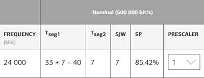

If i remember your clock was 24MHz so these are the settings for 500/kbs

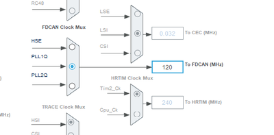

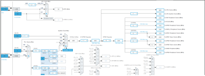

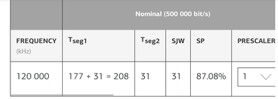

I changed the clock but I don't know if I did it right.... And should the Clock for FDCAN be set to HSE?

THANK YOU VERY MUCH !! By the way, can you tell me what this tool is?
