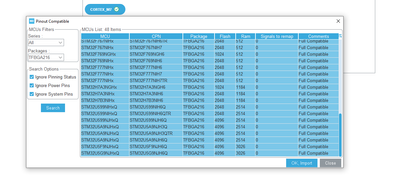

I suggest you use the last version of the STM32CubeMX (V6.11.0). Create a project using the STM32F779NIH6 then select the List of pinout compatible MCUs on the pinout Menu. You will have a full list of MCU that are pin to pin compatible and you will have data about flash and ram size of each MCU:
You can select the one you need.
