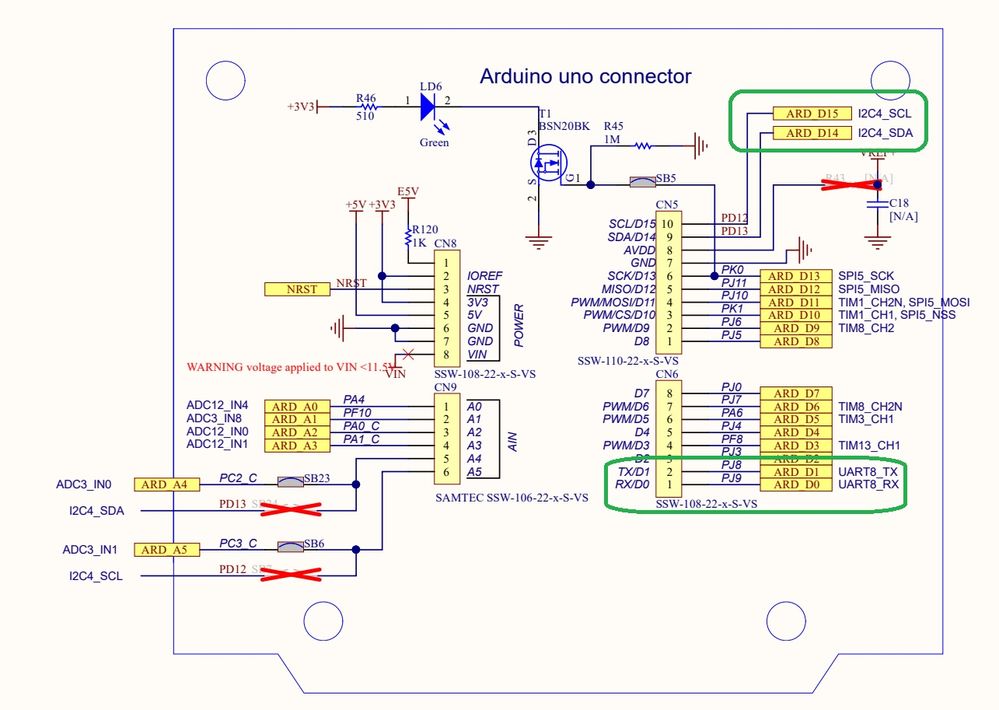

Could i use the VCP on the board is on PA9/PA10(pin D14 and pin D15 to rx and tx to arduino) and use digital.read on arduino to get the information of char[] like tipo "%s %.0f%%"?

No, D14/D15 are ball numbers on the BGA, not pins on the Arduino rail connection.
To use D0/D1 serial you'd need to use UART8 (PJ8 / PJ9), and then actively forward the traffic too/from the ST-LINK VCP connection

VCP is linked to an instance of USART and physically mapped Pins. Otherwise, you may use another board as VCP.
You may need to check the user manual for the instance linked to the virtual com port. Also, you need to refer to the datasheet to configure the related mapped pins.

The ST-LINK/V3 VCP being linked to USART1 (PA9 / PA10)
