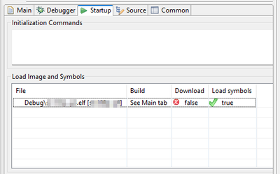

Get the chip into the "bad" state, then attach a debugger and see where the code is at. Create a new debug configuration to do this which does not reset the chip or download the program.
2025-04-11 5:45 AM
I'n not quite sure how to attach the debugger without also reflashing. If I uncheck 'download' from the startup tab in the debugger configuration, I cannot connect to the ST-link it seems. The console shows the following:

Yes, setting 'Download' to false on the 'Startup' tab should do it.

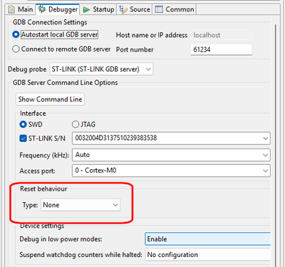

You'd also want to disable the reset on connecting:
Does your code go into low-power mode, and/or reconfigure the SWD pins?
